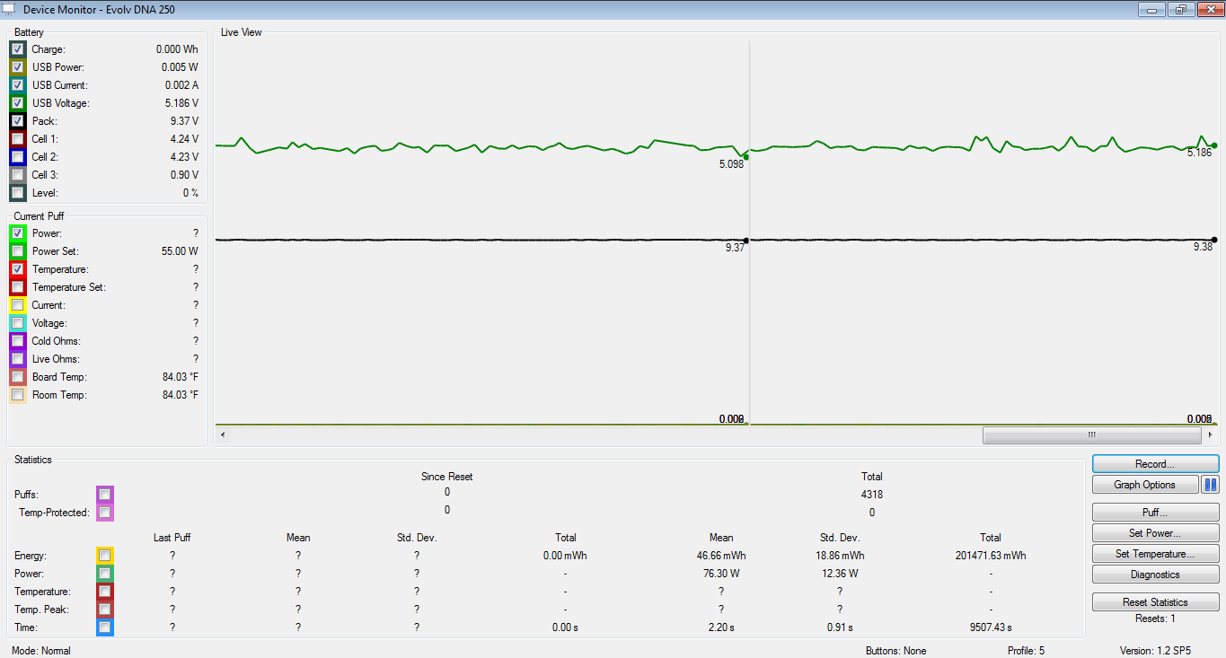

  10. i will try to tell him the problem. but is it okay to still use it? i mean i will use escribe to read ohms , wattage?

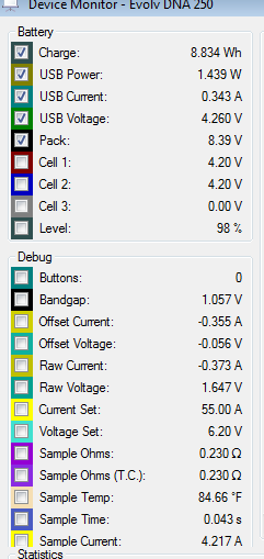

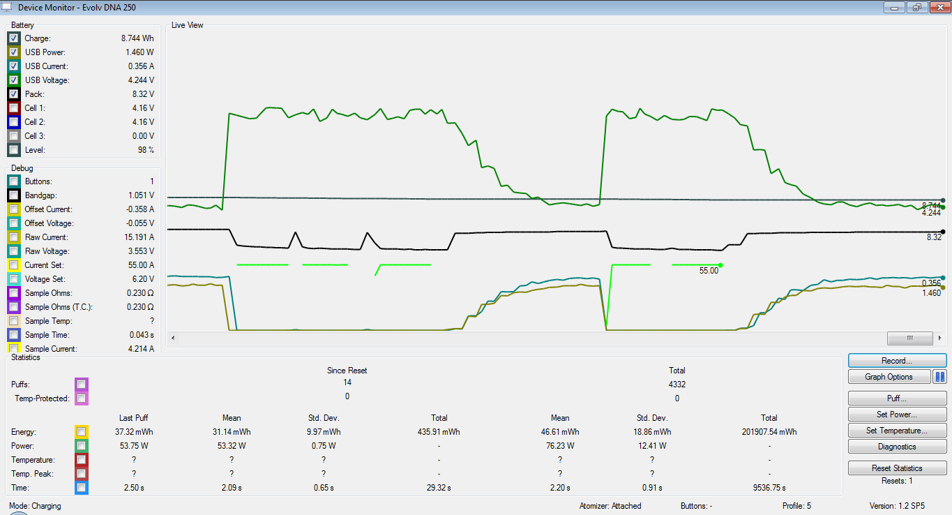

  12. Here is the screenshot when im firing it. I've notice the Buttons on the right corner is not responding.
  13. its on normal mode sir. Some says it could be the ribbon. but idk how to fix the ribbon
