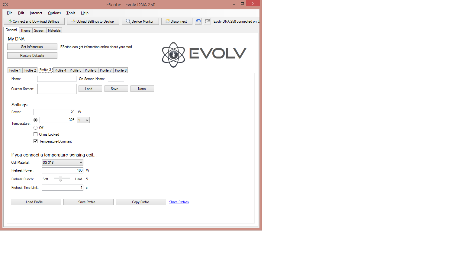

  1. giz_60 I can not for the life of me figure out how to load the new SS 316 profile.
  2. giz_60 IS it safe to set the power and preheat so high?
  3. Ok first let me thank you for your help for your help giz_60. I changed my settings in escribe to reflect your suggestions, It seemed to have worked! I have attached images of both the new settings and the device manager. My question now is where the heck did I go wrong???
  4. The device doesn't fire it displays temp protected.
  5. giz_60 here is a shot of my SS 316 profile, I would be happy to take a shot of the device monitor screen but what are some of the boxes that I need to check? Wayneo I did make sure that my connections are tight retird I wasn't aware that the coils need to be spaced... I removed the cotton and spaced the coils and it fired in temp control, I rewicked and juiced and spaced them again and again it is the same issue where it displays OFF. I am stumped EDITED now as I try to fire this device I get the temp protected screen...
