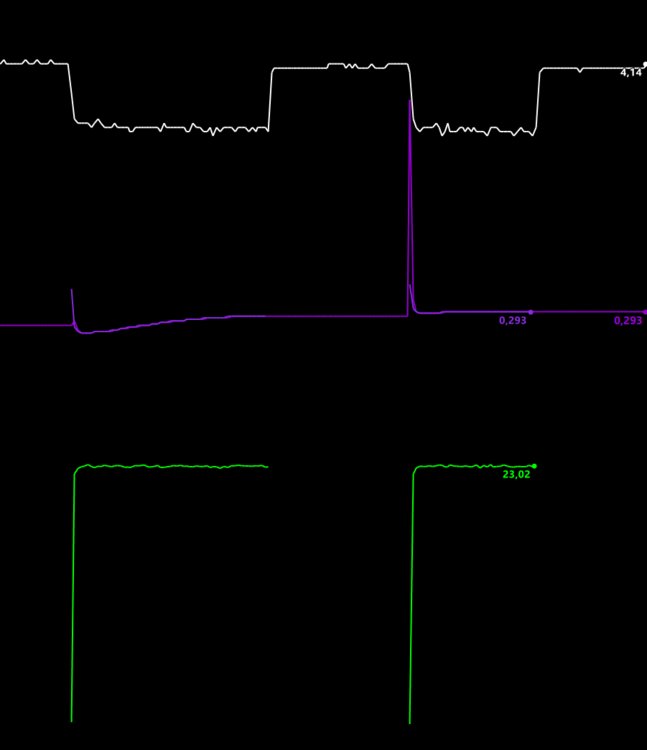

  6. Heres how puffs on wattage mode looks like, 23 watts.

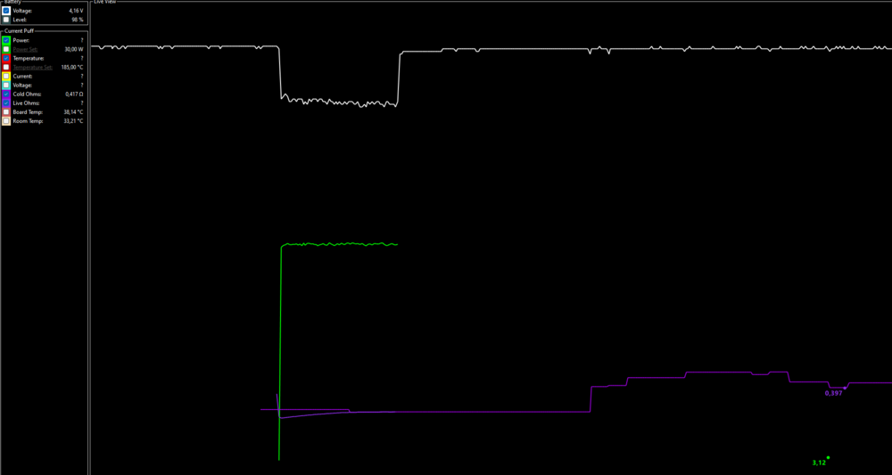

  7. Weird thing is i cant show temperature on the graph. So i did short puff(green line). 30W, 185C, after it i cannot puff anymore, ive tried and "cold" ohms go to some nuts 0,4ohm value. Im getting temperature protected error as soon as i press fire, puffing before i press doesnt help. After i waited few mins to cool down device, live ohms are 0.42, wtf? And yes, i checked with only the TITA RBA screwed into 510, and with the cap on. is working fine with my Hyperion dna100. I cannot obviously screw the boro tank into it.
