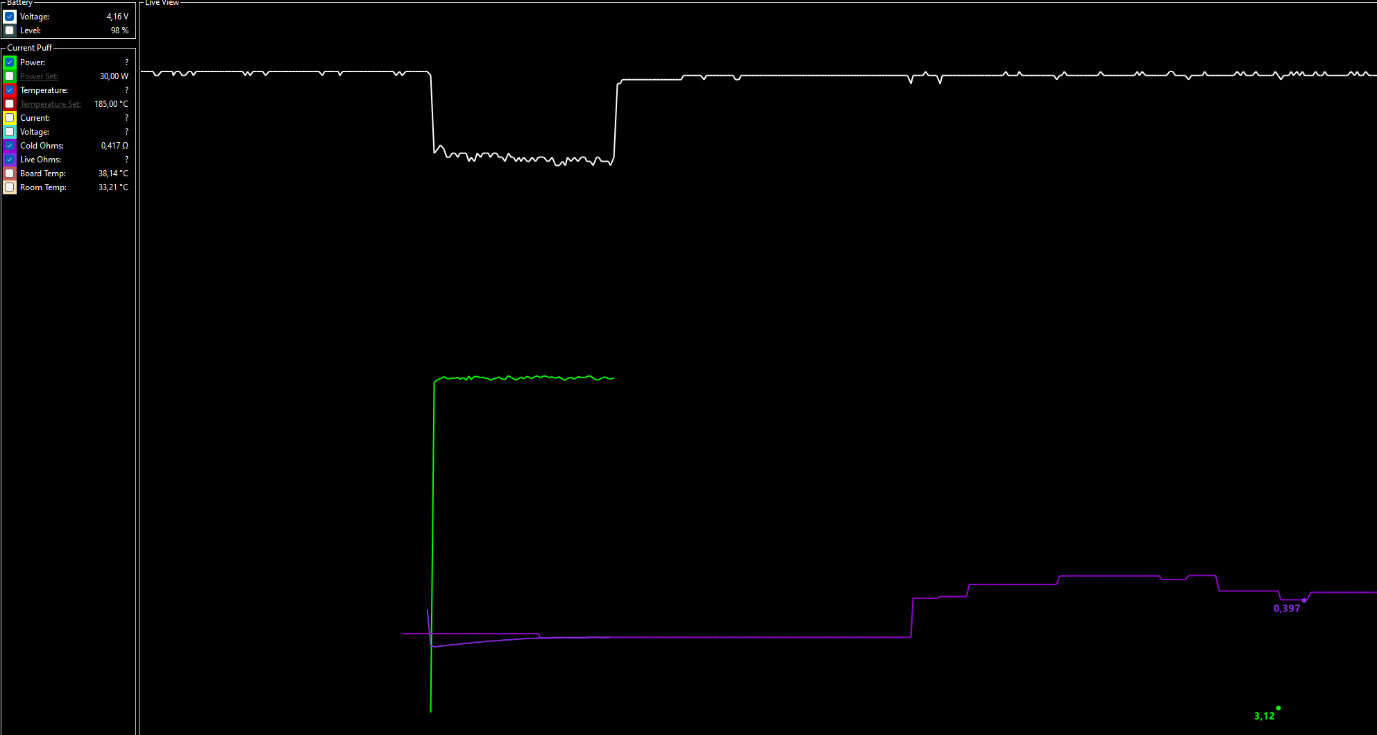

cytrus224's Achievements
  1. Noticed one weird thing. Ive set device to 6 watts on wattage, it reads 0,32 cold ohms. Ive then set it to 60W(max), it read 0,25 cold ohms. I've also managed to test the rba on my DNA100c, it read 0,206 ohms. Didn't have any issues with TC. I have no idea what to do now.
  2. I know, but it shouldn't read over 0,4ohms on TC mode, when on wattage i can vape, and it shows 0,27-0,29. I still have no idea why it would do that.

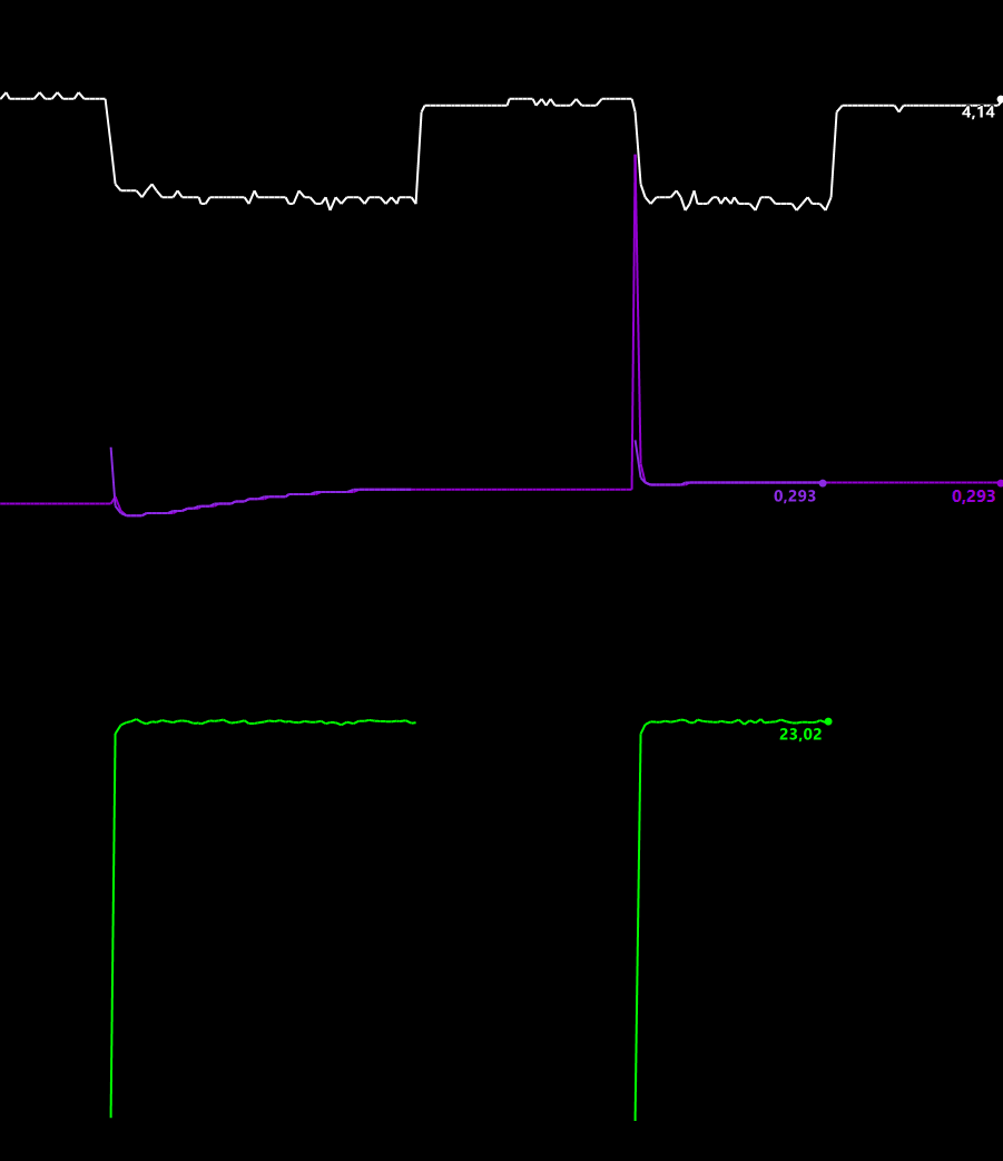

  6. Heres how puffs on wattage mode looks like, 23 watts.
