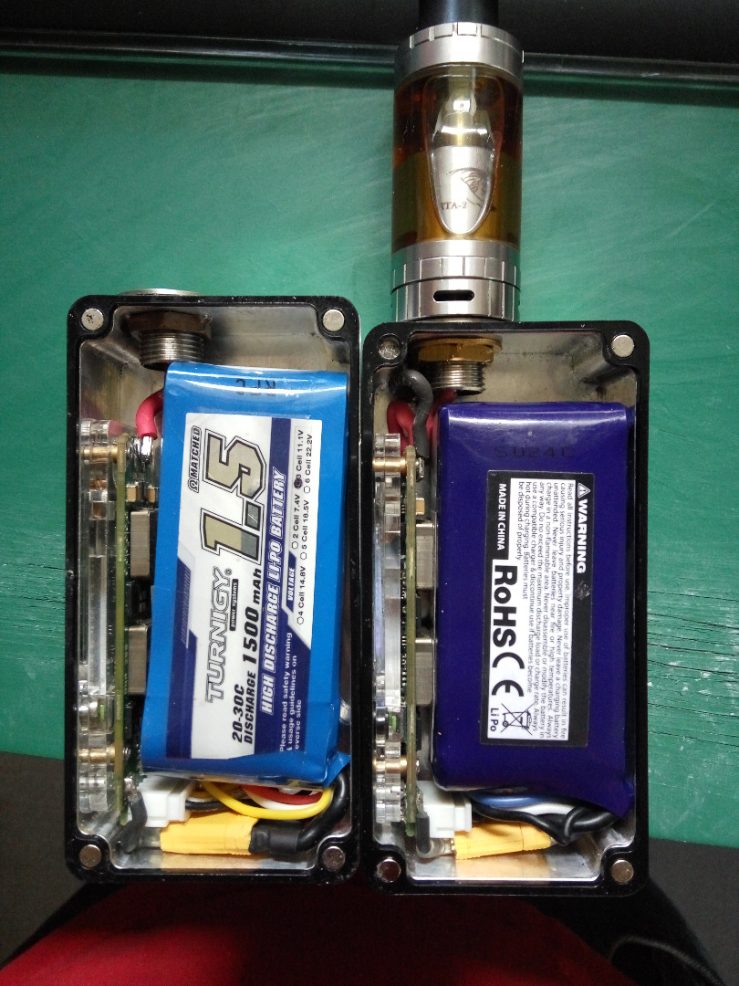

  6. Another guy suggested this? http://www.hobbyking.com/hobbyking/store/__11903__Turnigy_nano_tech_1300mah_3S_25_50C_Lipo_Pack.html which would fit perfectly into the casing I am thinking of getting, is it okay? He also sent me a pic of a 1500mah in his mod though the casings height is 22mm and the exact same battery I checked was 28mm so dunno how it fitted.

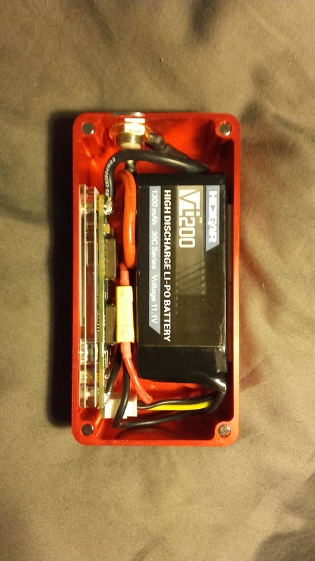

  7. I've decided on a HCigar VT200 Replacement 1300mAh Li-Po Battery Pack with dimensions Depth 19mm Height 67mm and width 29mm and trying to order the right casing/enclosure. Just wondering what is the depth and width of the DNA200 chip in a mount like the one here? http://www.stealthvape.co.uk/image/data/Acrylic%20Parts/DNA200%20Holder/dna200-screen-holder-screen%20slice-midframe.jpg
  8. " for the price of one, even better thanks
  9. Would the Hcigar VT200 LiPo battery v2 be okay? The Dimensions: 68mm*30mm*20mm look good for building though it's 25e over here so a bit pricey though I guess I could order and have it within 2 days.
