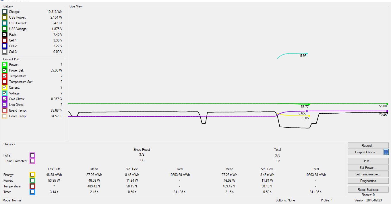

I get what youâre saying and have also heard other opinions that match but donât trust Ni or Ti, just a personal preference I guess. true there are a lot of imperfect products out there but hey theyâve come a long way in the past year looking forward to the year to come to see whatâs new and maybe and hopefully some improvements in quality and standards across brands. Iâll be honest with you both sometimes I get the best vapes on these crowns and a few bad, but when they hit good they really hit good. Gave up on running these on temp, even when you get them to work well, they all of a sudden spike and something goes wrong.. power mode is good for me. Most times I donât get problems with running the .5 @ 55 and damn do I enjoy it at that wattage 44-45 is too low for me, not sure how to explain it further. Just the combination of the density, flavor, and even sound of the draw just hits the spot. Also to further confirm, I did put in another crown with a .25 and confirm it could run at higher wattages without a problem which confirmed the 5.95v limit set by Evolv. it does go off of the warm ohms reading which is why it does fail sometimes on the .5ohm coil like joe said the .5 is reading at .63 - .65 and the .25 @ .33-.35 ohms.Oh and joe sorry to hear about the surgery hope the wife is recovering well and wish her a speedy recovery. Hope I didnât miss anyoneâs reply.

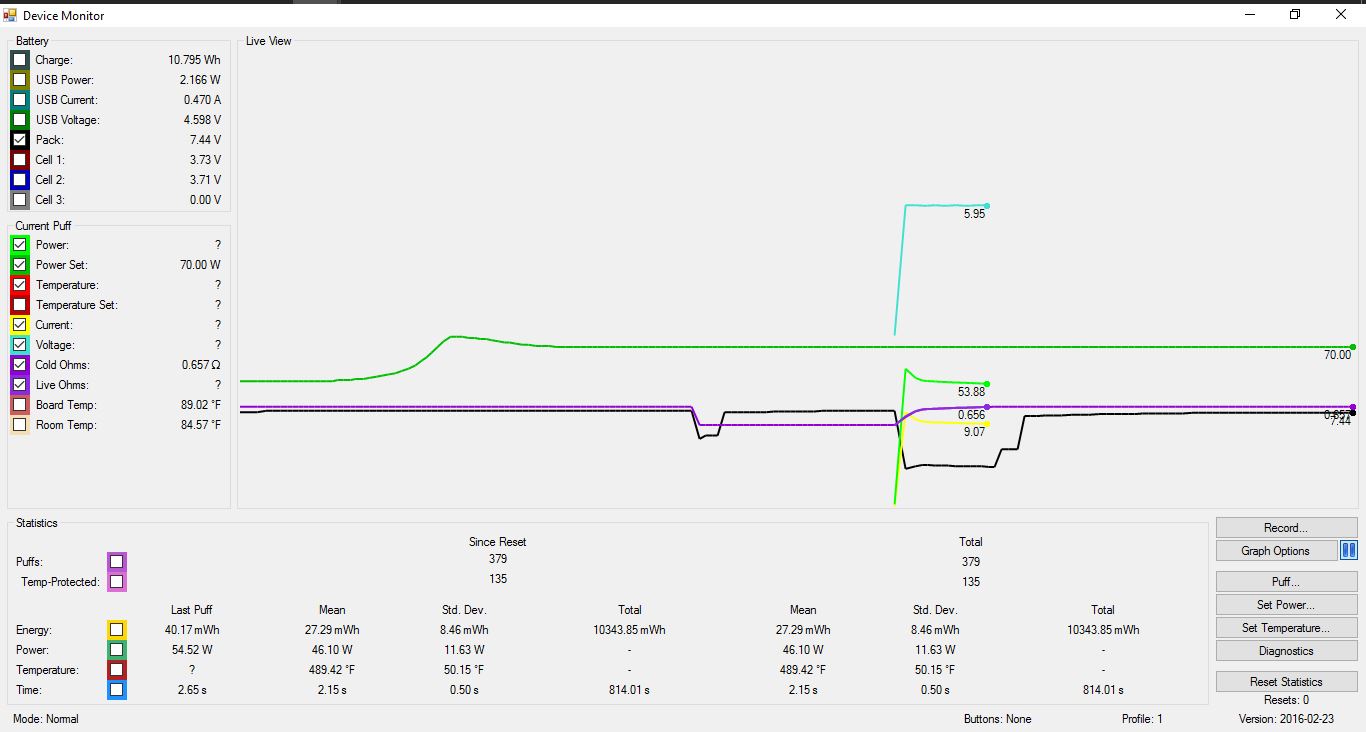

i did but thought i was reading it wrong like i said its a 0.5 coil reading at 0.51 cold the calculator indicates it can go up to 70w but heres where it all goes wrong the reading changes after a hit to 0.65 and that requires higher volts. but thanks for the tip.
hello everyone, great participation, really appreciate all your help. ok so question, why is it changing to .65 ohms when im vaping a 0.5ohm coil that initially reads 0.51 ohms cold. based on the ohms calculator it seems the limitation kicks in only due to this rise in ohm reading which based on my understanding that it should not change and be set on the device be it in power mode of TC mode. i get what your saying now though. I just wish i hadnt just bought 2 sets of these 0.5 ohm coils. luckly ive got a pair of .25s that i can test out.

On a non related topic, could you kindly explain to me how the resistance locks in the DNA am I right to understand that it automatically locks unless there is a variance of 25% it then resets it to the new reading. reason I ask is notice the resistance in the charts it spike to 65 ohms and not sure if its normal. I've attached the charts one @ 55w the other @70w. I see it hits the 5.95 limit however shouldn't my batteries be able to withstand the higher needs (2x LG HG2 3000mAh 20A 3.7v). would t be accurate to say as long as I use the 18650s I wont be able to vape with high wattage unless I attached a higher rated ohm coil? or can I tweak the battery settings safely to allow for the higher draw. Another thing I don't get and id probably get shot for this comparison but how come my cuboid 200 allowed this but the DNA doesn't.
