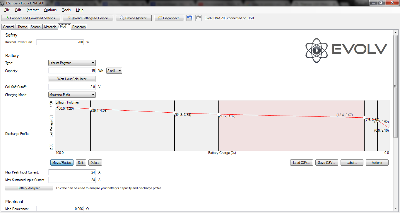

  9. Hi i have a problem with my Vt75 nano about ohm resistance. my ohm is not set in every puff. every puff mean different ohm reading. Anyone can help? sorry for my broken english, i wish all of u can understand. Thanks

  11. this is the printscreen of my battery setting. when i use this setting (lithium polymer) , my mod cannot fire and show 'check battery'. and my battery display still empty
