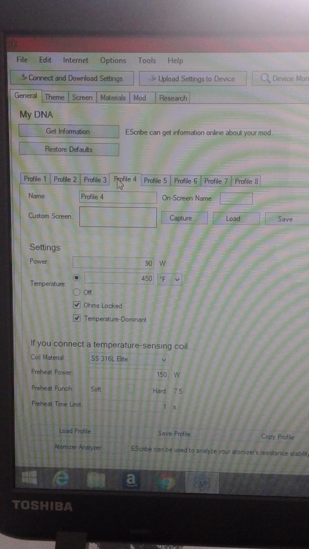

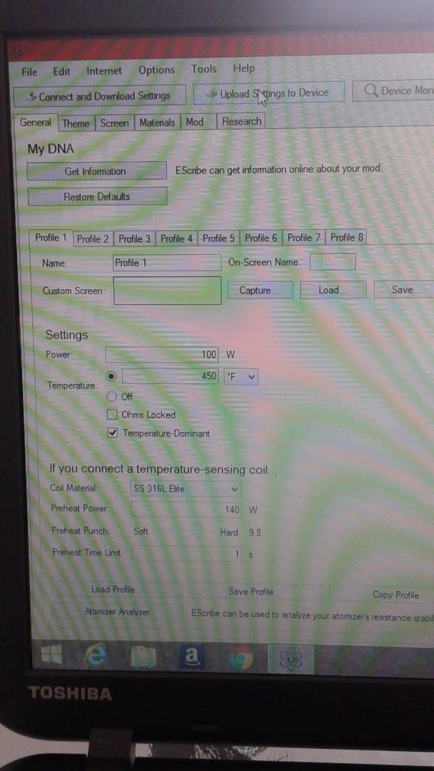

	Yes!!! That's what I did!! Now your speaking my language. Lol. When I get home from work in the morning I'll give that a try......then go from there. So the file for the 166 is under-file- open file?
	The 166. I can never find anything for 250. It's always 75 or 200.

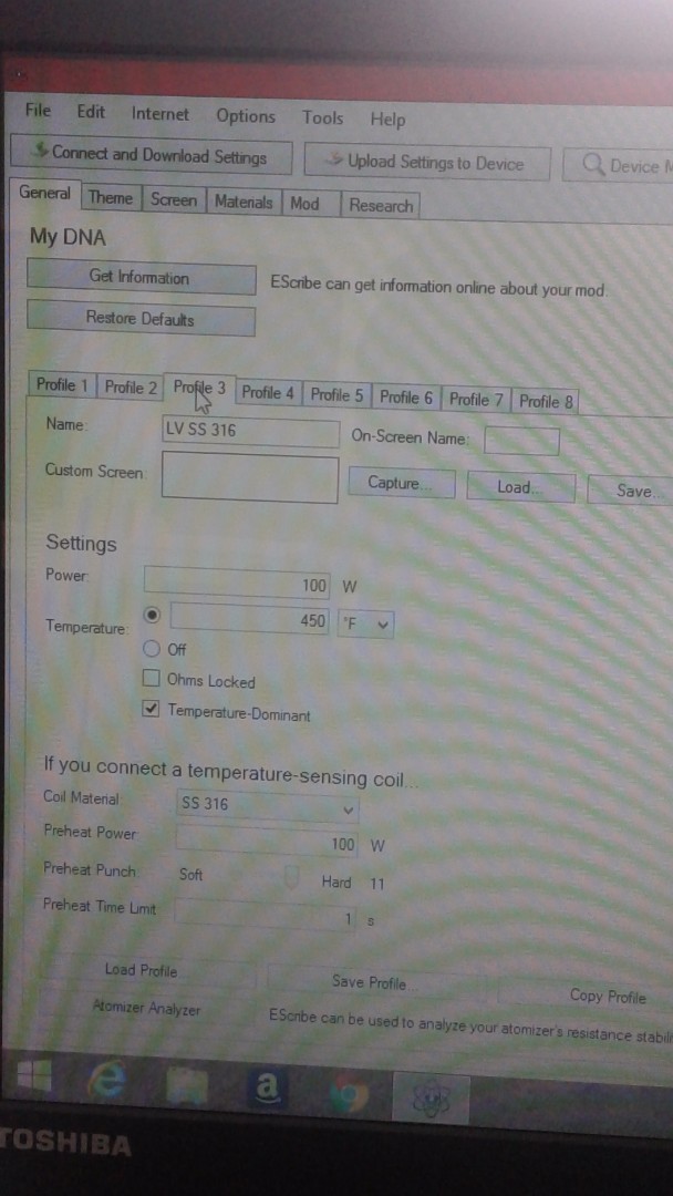

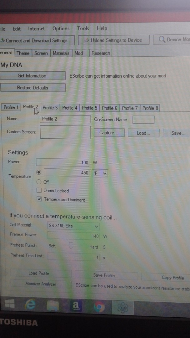

	Plus, they have the pre loaded profiles....it worked for those 2 days....they say I shouldn't have to use e scribe. Only if I want to make adjustments. I don't care about adjustments right now....i just want it to work.
	Yea, I've watched a bunch of videos, read a bunch of forum stuff. Idk, I'm still not comprehending it. I work crapy hours, and have 2 kids. I barely have time to sleep. I didn't realize so many factors would matter just for me to vape. What day it is, the weather outside as opposed to inside, if I'm left/right handed. Lol. I just want to know what numbers go with what settings, so I can press fire and vape. I don't have time to take my laptop out and change settings every time I want to change my atomizer, or the weather changes. I appreciate your attempt to help me, but I think I'm a lost cause. Just sucks. The 2 days my mod worked in temp control.....i loved it!!! Then I plugged it in to escribe......never worked again.

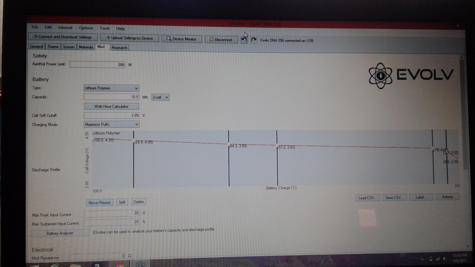

	Yeah I see where the case analyzer is and what not but I don't understand what it is and what it does after I do it or what It's trying to tell me. I'm just going to use the mod in wattage mode but I wanted to make sure the battery part was working correctly.

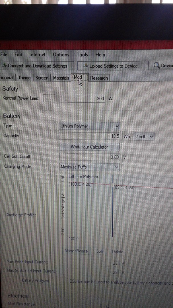

	Oh, I know the battery stuff doesn't effect temp control. I just wanted to make sure my settings are correct. The first time I hooked my mod up to e scribe it seemed like a bunch of my settings got screwed up. Like it got changed to 3 cell. I didn't know if anything else got changed because I don't know what the settings are supposed to be. I can't seem to find anywhere to explain any of this in "English".
	In the battery part. I'm running 25r's and LG brownies.....should my capacity be 18.5? Cell soft cutoff 3.09v?

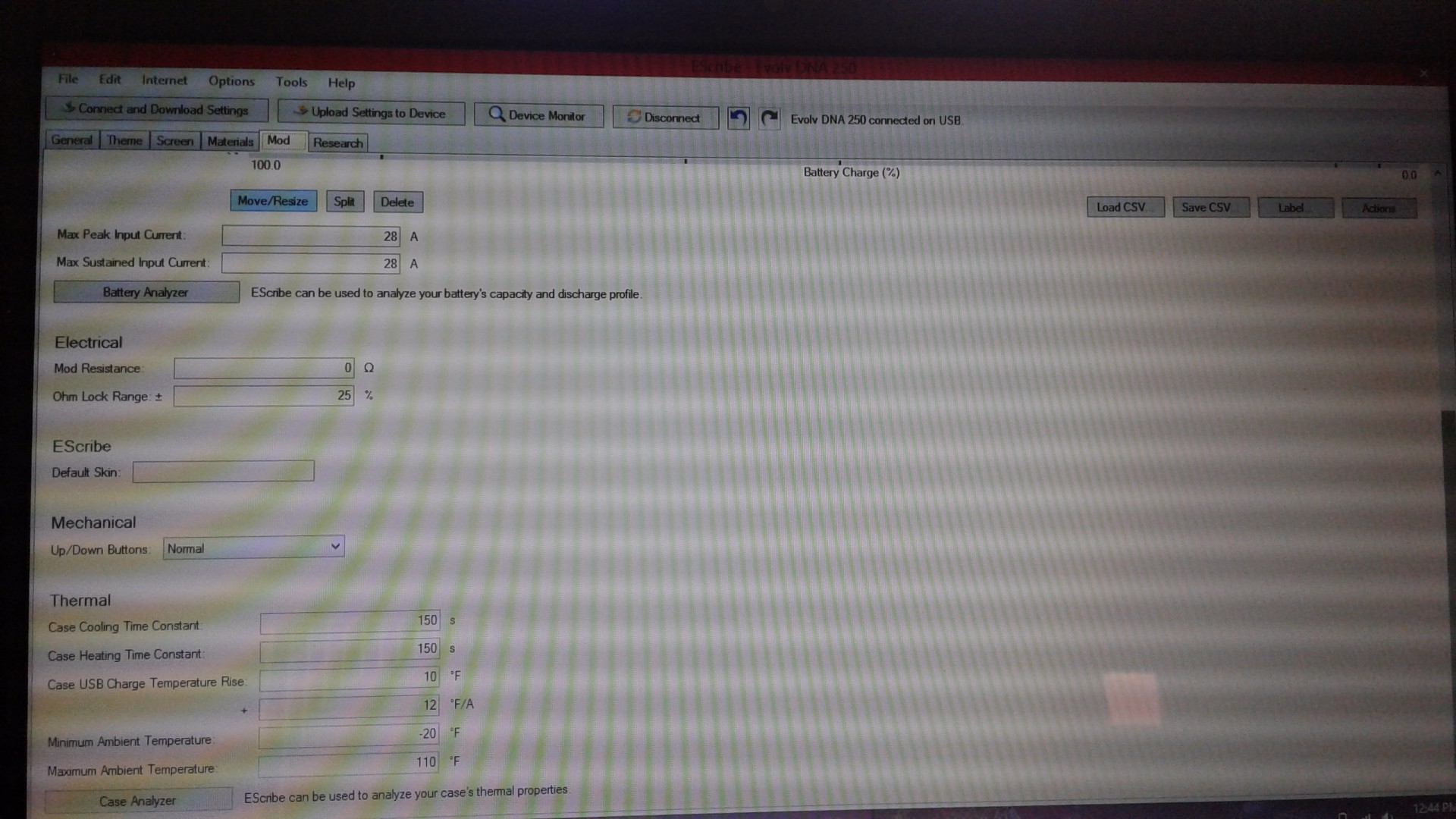

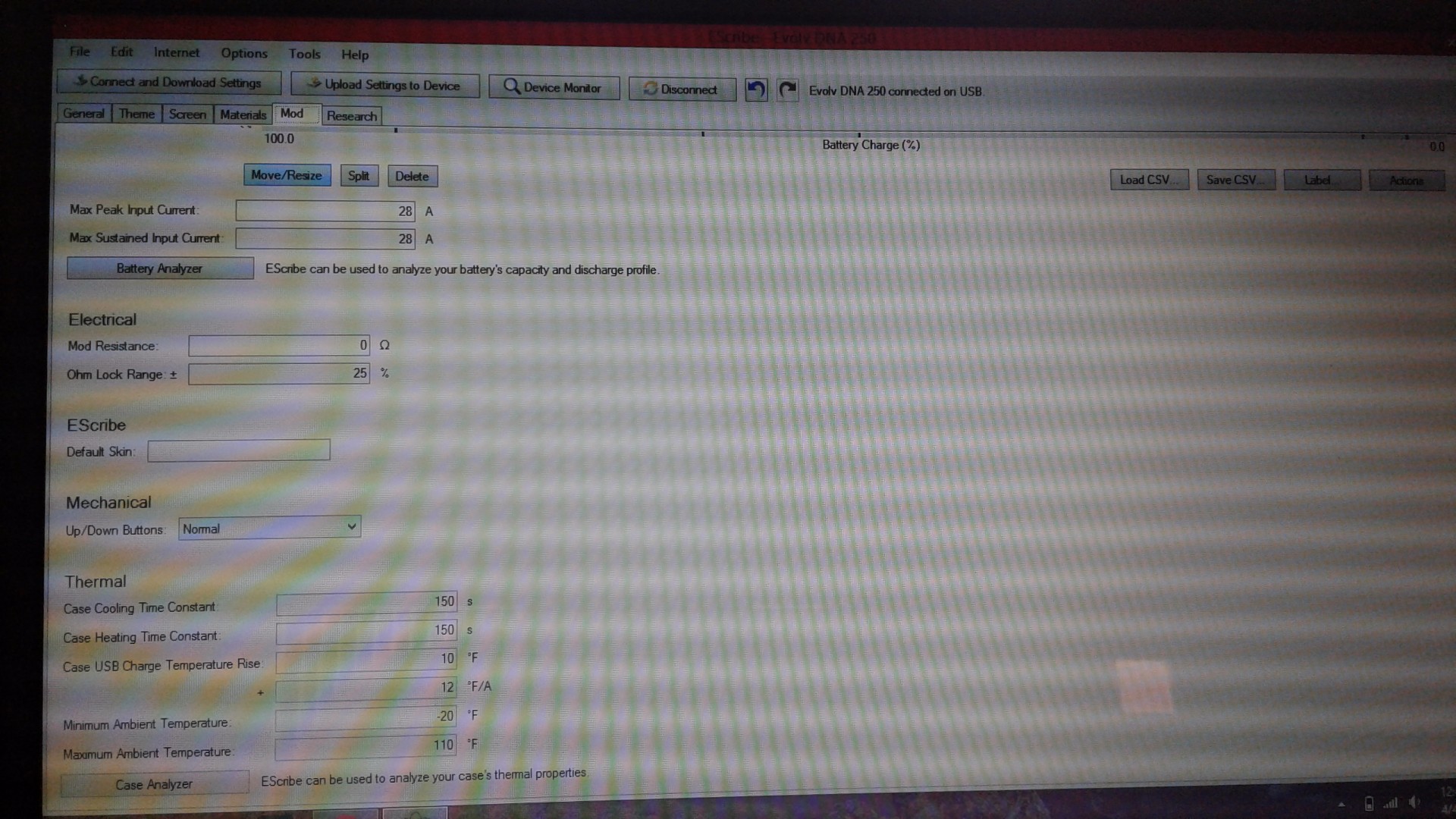

	I've cleaned everything with rubbing alcohol. The screws on my goon 24 are as tight as I can get them. Mod resistance says zero? And unfortunately all the other stuff is like speaking Spanish to me. Lol. It just sucks, I like temp control, but wish I didn't get a dna. I didn't realize it was going to be this difficult. I need a cigarette after every time I mess with this thing....smh. kind of defeats the purpose.

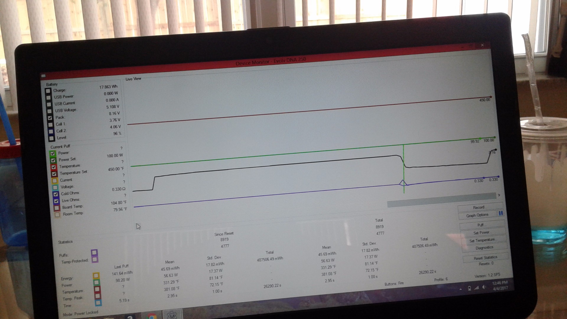

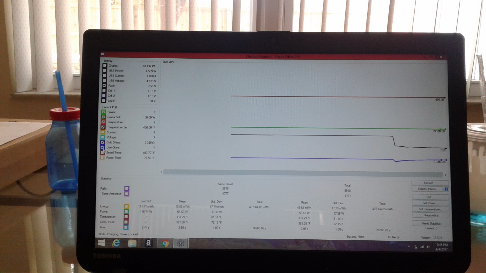

	No matter what I do, what settings I change, when I run the device monitor, temp doesn't even register. Temp control doesn't work.
