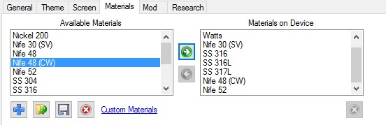

	  can you rearrange order of materials on mod?alfie replied to alfie's topic in EScribe, Software and Firmware Thanks for your thoughts retird - any suggestions on this are appreciated. Looks like it's one for the boffins who do the programming. I also tried renaming them all so they start with a number to see if it would then put them in numerical order - that didn't work either. the order must be to do with wire properties
	  can you rearrange order of materials on mod?alfie replied to alfie's topic in EScribe, Software and Firmware good idea, but sadly no cigar on this occasion I wondered if it was to do with whether they are CSV or TCR but it's not that either I also tried changing Nife52 to just Nife and re-adding it to the mod but that made no difference either; it appeared directly below nife48

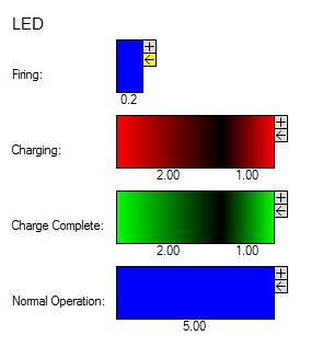

	hmmmm fixed it but I don't understand why..... I had a feeling the purple is the led's attempt at doing white, so I set normal to this setting: it worked, the purple light disappeared. I then removed the 1 second gradient - and still no purple. Like I said, no idea why this worked. but it did Thanks for your input retird, it's appreciated.
	  can you rearrange order of materials on mod?alfie replied to alfie's topic in EScribe, Software and Firmware Hi folks I've switched around the materials stored on my mod, adding some I use and removing some I don't. that bit wasn't an issue. what confuses me is the order they appear in: It's not alphabetical (it is on the left box, but not the right) It's not the order that I add materials - I tried deleting them all and re-adding them but it made no difference. Has anyone else noticed this? and has anyone got a way to sort this please? If I can get Nife 30, 48 and 52 to appear in a group, I'll be happy thanks
	yep, for a couple of secondsand even if it's not charging (the only option set to red) I get the purple if I let it go into standby and then press + or - rather than fire charging is red/black charging is green/black firing and normal are the same blue it's confusing me
	I've got an SMY sdna75 I've got colours set for fire, charging, charged and normal but for some reason it glows a weird purple colour for a couple of seconds after I've taken my finger off a button. I thought this was when the "normal" colour was supposed to come on.... Normal is set to blue; none of my colours are set to purple. Any ideas why it might be doing this please? Thanks folks
