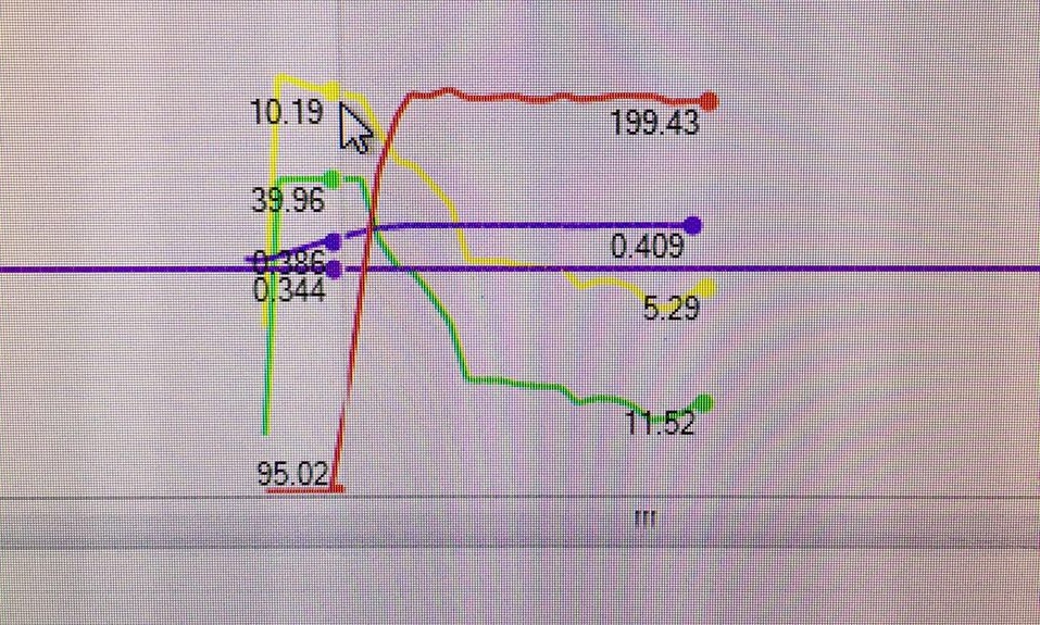

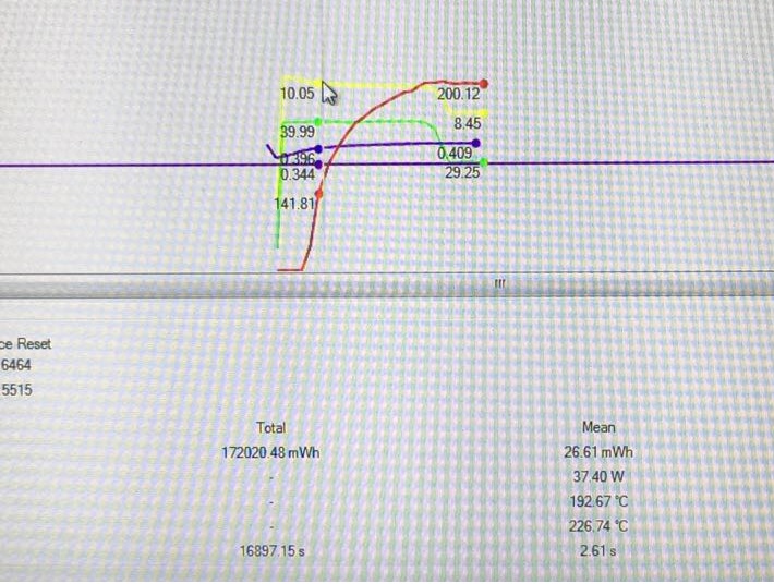

I have built my usual 2x26awg twisted, 3mm ID, 7 wraps spaced, SS316L coil yesterday, and it came out to about 0.34 ohms. The coil was only gently heated (no glow) to check for evenness. I then locked in the resistance @ 0.34 ohms to ensure stability. (I hate the very slight fluctuations of refinement) My set up is DJaquith's SS316L profile, 40W, no preheat, temp set at 200 degC. I was happily vaping it with the Engine Nano. So after 6 tanks or so, this afternoon I felt that the cotton wasn't wicking very well anymore. I took it apart, removed the cotton and dry burned it. I used power mode 10W and let it glow, followed by a quick rinse in tap water. I also brushed it with a pipe cleaner to remove all the gunk. Final rinse was done and the coil was dry burned at 10W again till glowing and dry. The coil settled at a dark grayish colour after cooling down. After rewicking etc, I took a vape and I noticed that it hit my temp setting of 200 degC way faster than this morning. Do any of you TC SS coil users experience this as well? Is there a better way of completely cleaning the coil? Before cleaning the coil After cleaning the coil -
