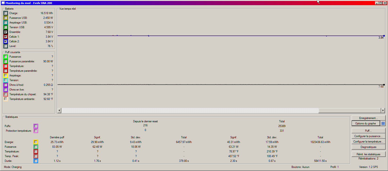

  5. thanks for the usefull link not vaping, no touch charging since this morning, and now it discharges ! 3.83 instead of 3.84 ! i tried yesterday other set of battery, it's the same.
  6. ah ok, lol, i thought it was an option in escribe it's sony vtc5 about 3 months old i set the Wh at 19.24 with the calculator
  7. here is an other screen battery info : where can i found this ? Other thing i can't do a battery analizer because he is waiting for a full charge, and of course, it allway charges
  8. Hello my dna200 doesn't charge over than 3.84 per battery (sony vtc5, 2 cells), same problème with other new battery. The screen show the graph with 600s time The % goes up but not the battery ! I don't know what to do, please Thanks
