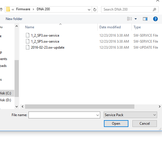

  3. thank u. and few more questions. 1. how can i update firmware for board and where i can found latest one? 2. how can i update software for escribe and where i can found latest one? 3. one of my mods (that one that is not waking up without usb) also drains battery imbalanced and makes them not working.. what may be issue?
