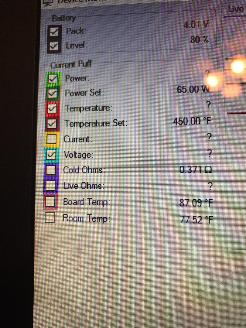

  2. Now I'm getting the cold ohms setting. But then a while bunts he of errors start coming up. Bizarre

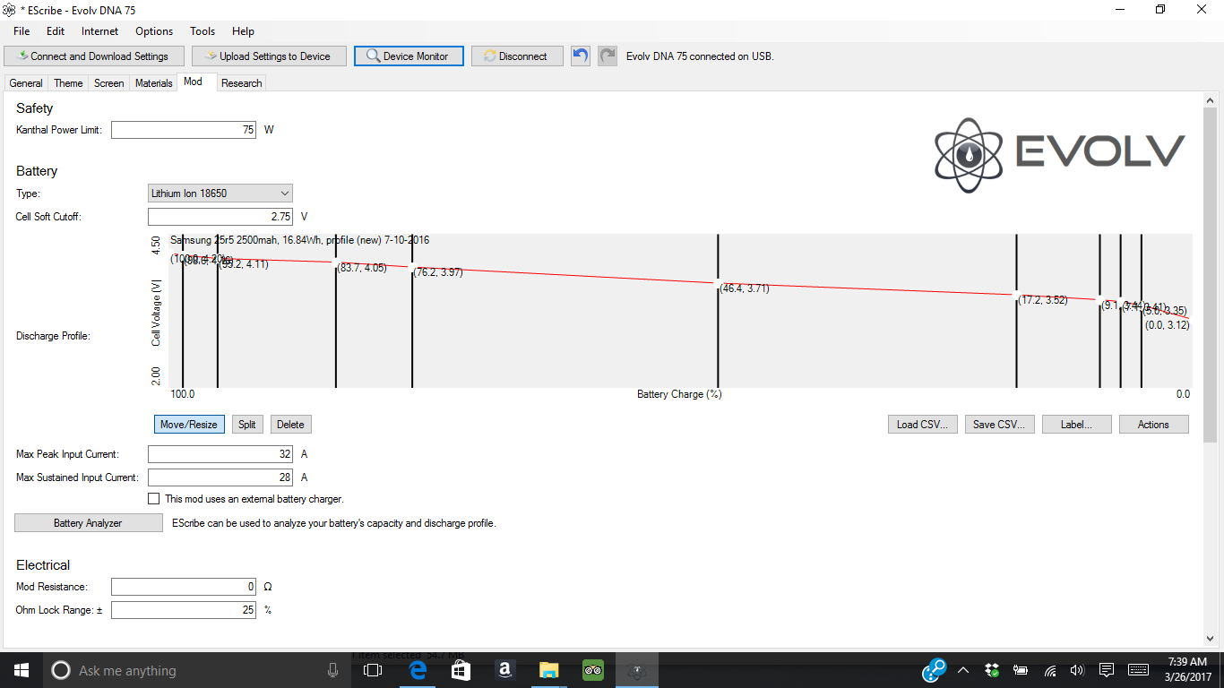

  4. Ohm Law 6 wrap coil ohms .257 my 26g/36g kanthal/n80 voltage is 3.7V amps are 19A 5 wrap coils ohms .117 26g/32g kanthal/316l voltage is 3.7V amps are 16.4A ohms .09 24g/32g 316l voltage is 3.7v amps are 39.8A 10 wrap coils 26g/32g 316l Ohms .213 voltage 3.7v amps are 17.4

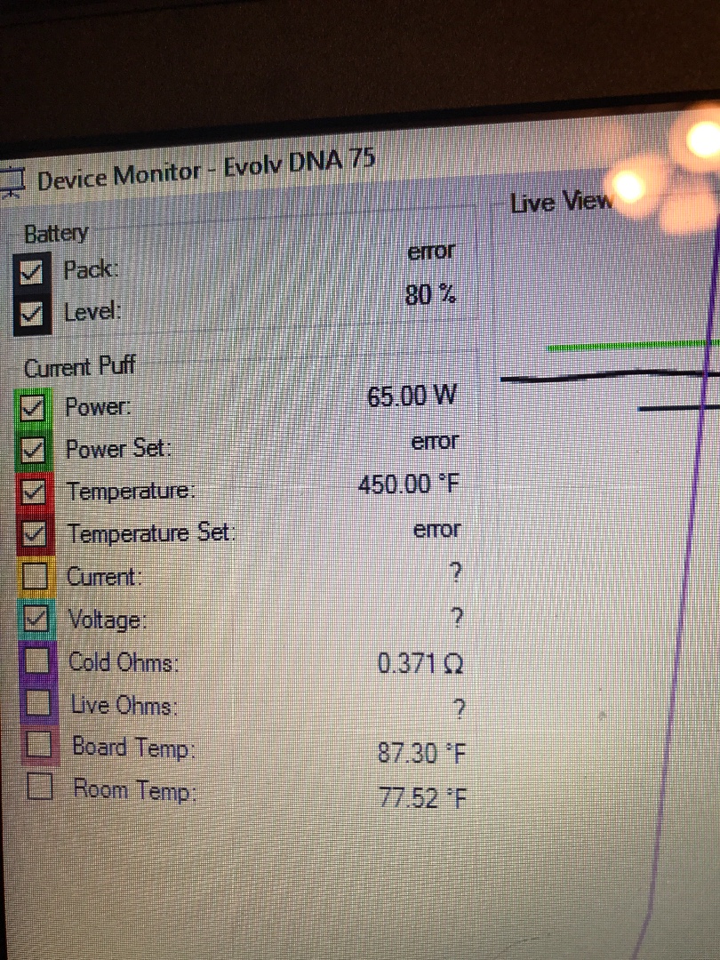

  5. I am having issues with getting the right amount of wattage to my device. I used a custom csv that I made using wire wizard on steam engine website for a dual fused clapton 26g/36g Kanthal / N80 wrap. I set up my profiles to use this as temp control and set the wattage to the max. I uploaded settings and when I fire the box up it does not hit max wattage. It only reaches 65 max wattage. I have tried different batteries (sammy 25r and sony VTC 4), and two different RDA's. (Kennedy 25 and a Apocalypse V2) Rda, my battery is fulling charged and the setting I have are as followed. Preheat Power: 75w Preheat punch: 11 Preheat time: 1s Power: 75w Temperature 450f Temperature dominant on. I have also built a fused clapton 26g/32g 316l with the same problems. Can somebody point me in the right direction.

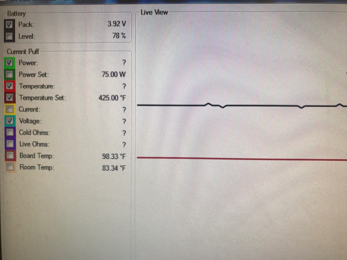

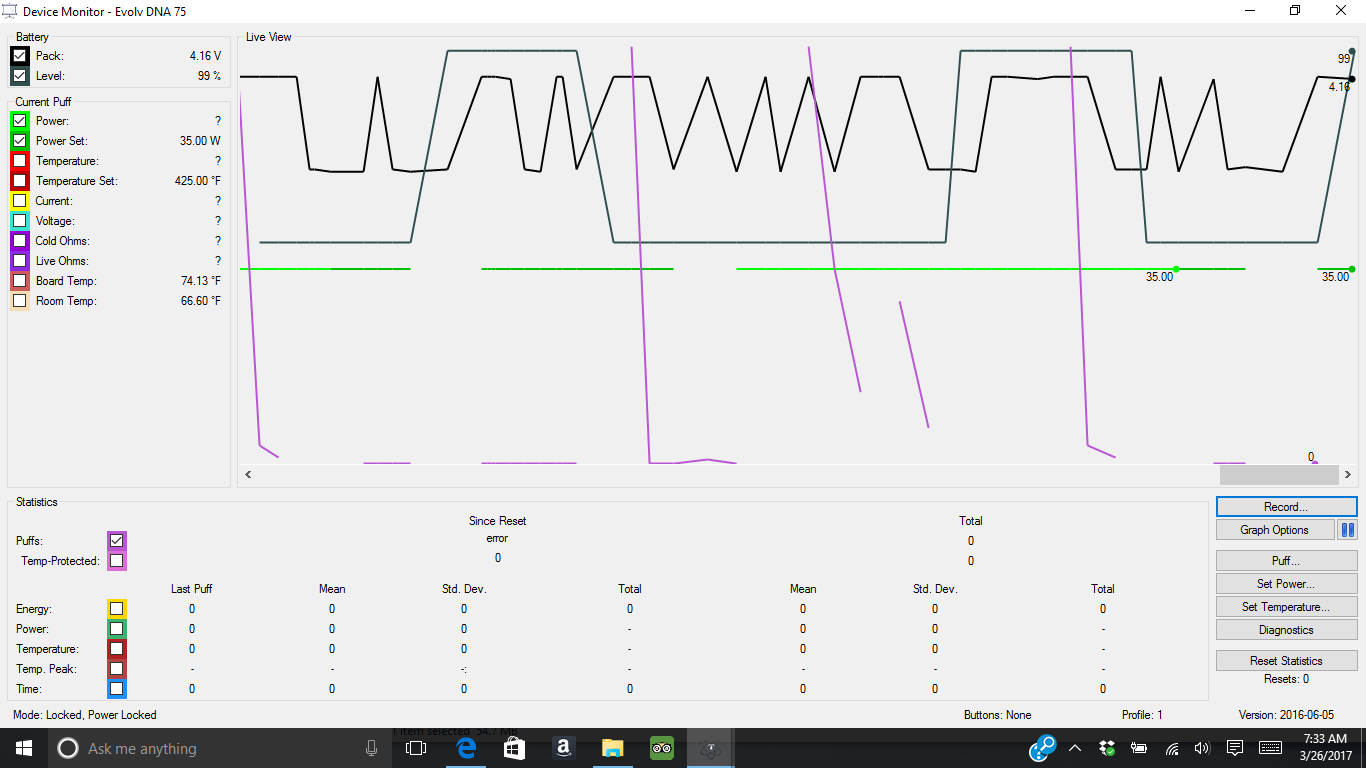

  8. ChunkyButt 200 thanks a lot for putting time and effort into helping try and solve my problem. Same goes for the rest of you guys. Here are the screenshots of the mod, and device monitor.

  10. Thank you for the file, but the problem continues.. I forgot to mention I accidentally added the a steam engine wire wizard csv file to the battery section resulting in a eeprom programming failed message. Curve has x coordinates that are too small. These are the steps I took 1. Intiated both a soft and hard restart. 2. Installed previous firmware 3. Made sure USB charging was checked on the escribe software 4. Changed battery. 5. Changed wires. 6. Installed CSV file. My mod still does not recognize the battery. I'm not sure what else to do.
