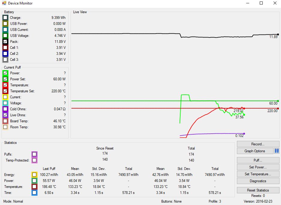

Griffin 22 mm  by GeekVape  evaporator profile. One experiment - 6 months of use. Here are all the files: logo, profile of the material, etc. 2х Ni200 hard  0,35 mm core + Ni200  0,2 , iInner diameter: 3 mm,  7 wraps,  Total Ohm: 0,04.  Power 60W / 70W preheat,  Coton "Bacon"  Material profile:  custom Ni200.
The Clapton coil should be carefully burned with a small burner. Good burning is the key to success!  Here is my review, which is unfortunately not in English:
