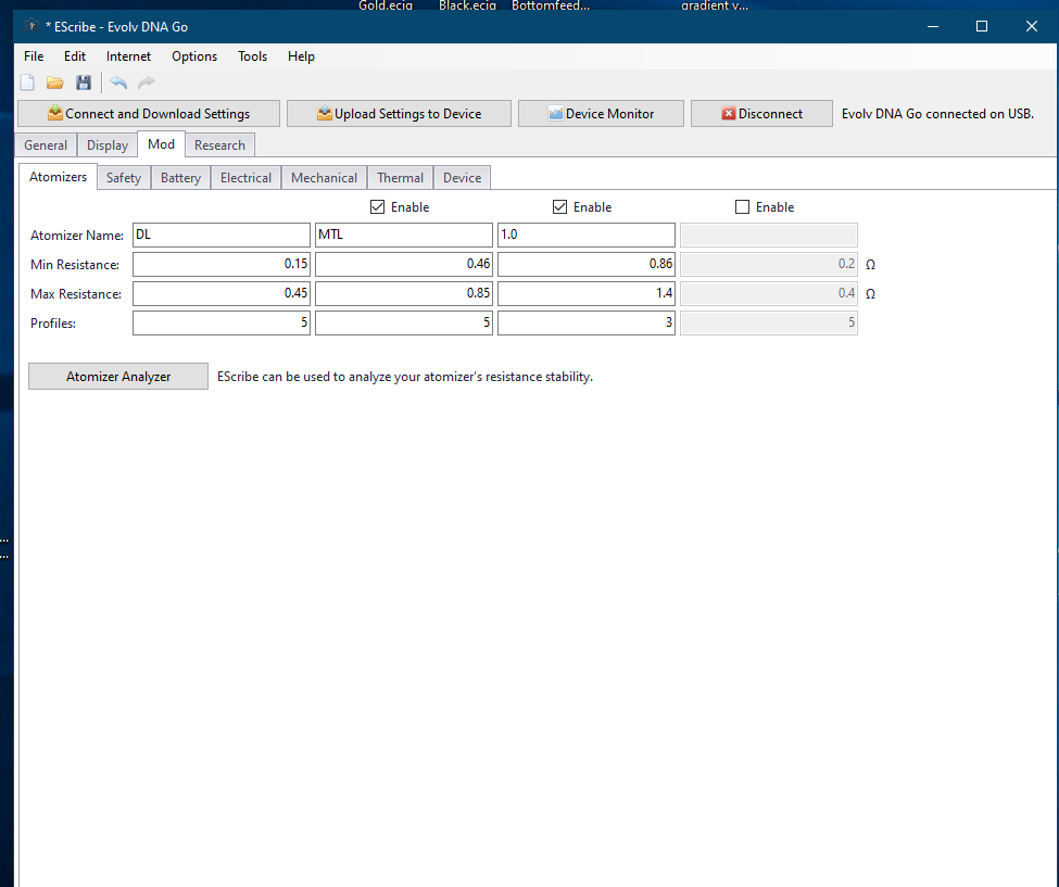

Installed the update and when I open eScribe it says Orion Plus and gave me the 5 factory presets for DL and MTL but did not give me a 3rd tab for 1.0.  Is there something I need to do that will fix this?  I am on a Mac and wasn't able to update to the version of eScribe shown on Lost Vape's instructions for the update (running Ver 2.0 SP19 which is all I could find for MacOs), would this affect it?
Share this post
Link to post
Share on other sites
You might look under the mod tab and see if 1.0 is enabled....
The instructions say:   Make sure the software installed is the V2.0 SP20
If you still need help see the last page of the instructions for further help..
I'm having the same issue, I was successfully able to upgrade to the Orion Plus firmware but I am not seeing the option to enable the `1.0` settings under the `mod` tab.
@Wayneo , I saw someone post a mac pkg for the Suite 2.0 SP20, but the link is dead. Could you please reupload and share? Thank you!

I was able to update to the Orion Plus settings using a Mac, however, the third tab is missing. I also wasn't able to get service pack 20, but have sp19

Your update was not successful (no 3rd tab) as you didn't fulfill the requirement of using the proper EScribe version.
From Lost Vapes instructions:
GET YOUR ORION PLUS IN 12 STEPS, 5 MINUTES
(*Only compatible with Windows System)
Please take down the pod before the upgrade.
Share this post

I used the escribe 2.0sp19. There was no tab for the 1.0ohm available.
When I went looking for the firmware, I searched manually to get the file needed for the plus. I posted screenshots in my previous post. I am not a computer geek or guru. But it looks like I manage to get the settings to use the new pod system, but unable to add the 1ohm Q pods. So my guess would be I have full plus control minus the Q pod setting?

TimmyW and all..... I must be out to lunch today and apologize to all  .....  forget all my other posts (deleted them or updated them)......  the Update requires 2.0 SP 20......  My old mind had SP19 in my head...... so Lost Vapes says the update only works with Windows.....
Checked my notes:
I wrote this to Lost Vapes on August 29:
When installing the Orion Plus Upgrade on a Orion it will not complete properly when installing from a MAC computer.  EScribe Ver 2.0 SP20 is not included in your install files for a MAC computer.
Please update your install procedure to also  include the MAC version of  Ver 2.0 SP20.
Please e-mail me your answer within 3 days as you state in your instructions.
Thanks.....
They replied on the same day:
The upgrade can only operate on windows system. MAC computer can not operate it.

Well I cheated. I did Windows Parallel on the wife’s computer for a 15 day trail period. I am up and running the proper firmware and software updates. I even unchecked the third tab to low the 1.0 ohm pods.
Might have to invest in Windows Parallel and keep it on the wife’s computer.
