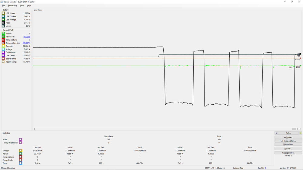

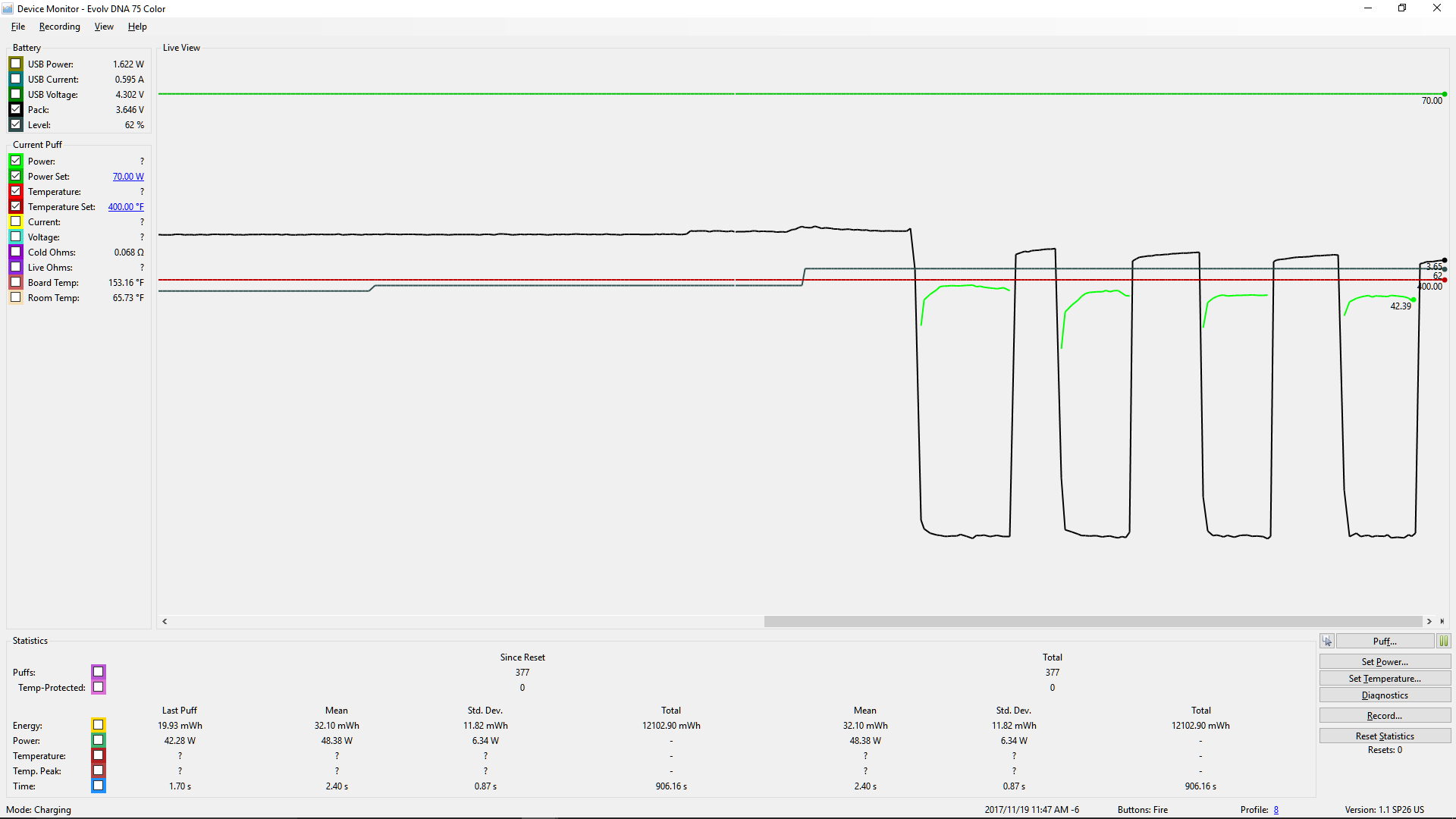

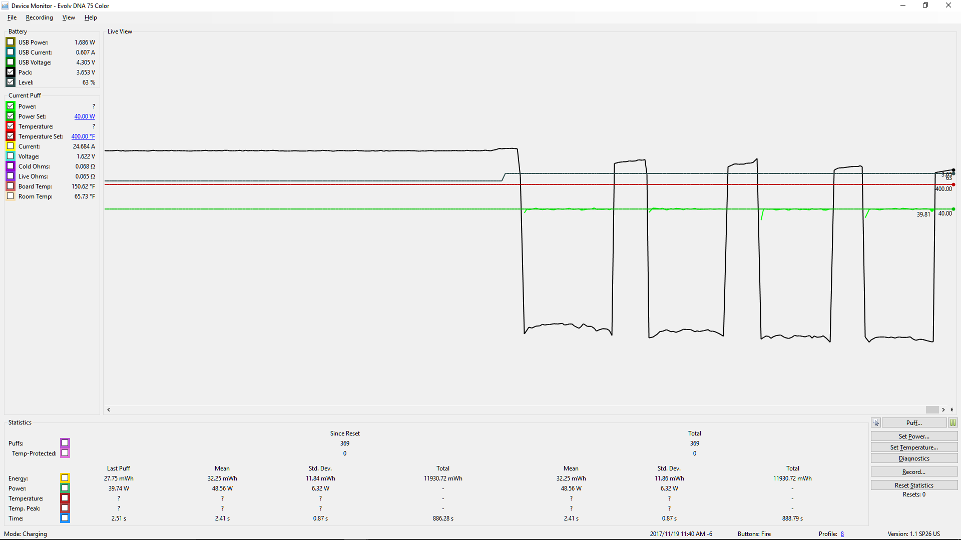

OK now that you have Device Monitor :
 What does it show, while firing, in Device Monitor?
Please post a screenshot of Device Monitor showing Pack, Level, Power, Power Set, Temp, and Temp Set (while firing) We need to look at this data to try to help you....

My thoughts....
Output Power Chart for the DNA75C can be found in this datasheet:
https://downloads.evolvapor.com/dna75color.pdf
Make sure the coil you build is within an area of the chart... looks like your coil (0.068 ohms) would require 32 amps calculated with Ohm's Law and your cold and live ohms is outside the range of the chart  The max operating range output current of the 75C is shown as 30 amps.
