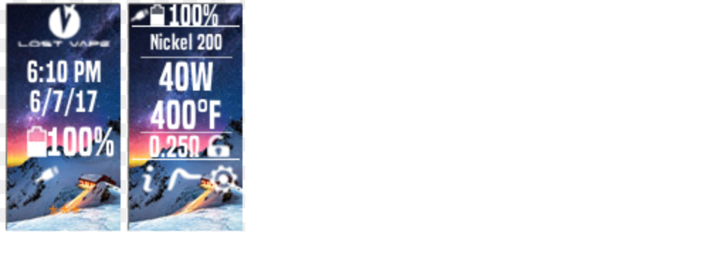

hello i just noticed that i cannot click on my info icon( the little i on the bottom left of the screen). When i try to select it it just skips over it and doesnt even click on it. Does anyone know how to fix this? TIA

Can you save a copy of the theme used in your device to your computer and then post the theme file here so we can look at the theme to see.

its the little i on the bottom left of the right-hand side screen. Its suppose to get me into like puff counter and last puff diagnostics etc. but my highlight indicator just skips right over it like its not there

Try going into the Theme Designer...Screens...select the main screen...click on 'i' icon....'Action>Set>Go To> Child Screen' & then select the screen you want it to go to...(Info Menu ?)
