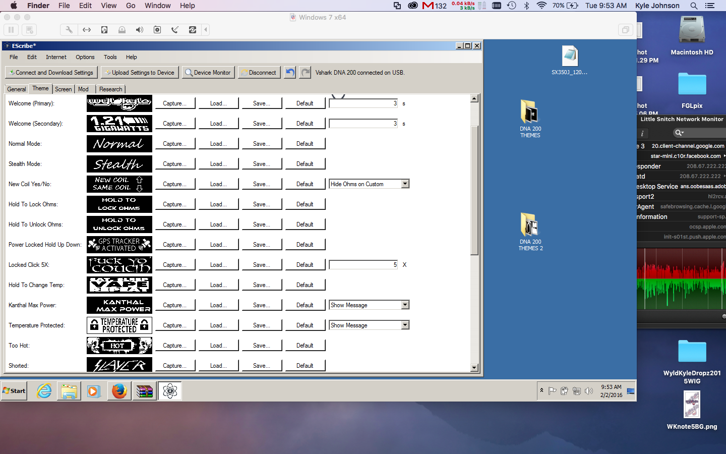

I wish I had your luck.  I'm on El Cap 10.11.2 using VirtualBox 5.12 and still no love.  I've tried plugging in direct to machine and through USB hub.  I've disconnected the batteries and cables and rebooted the VM between each attempt and I just can't break down the wall.  Still keep getting the same error as thekanthalkid's post right before yours.
@the_edge
Tried reinstalling the guest additions again.  Even did a scrap and reinstall of Virtual box and guest additions.  I've tried connecting DNA after windows is booted, before windows is booted and after windows is booted and escribe open.  Still no luck.  You got special Mojo I just don't seem to have.
@the_edge
Dude,
You rock!!!!  I swear when you posted your screenshot the only download available was Virtualbox 5.0.12. Today I saw 5.0.14 and took another crack.  First try and my Wismec Reuleaux DNA 200 is now recognized on the Mac onEl Capitan 10.11.3.  I heard the angelic choir going off in the background when it happened.  Thanks for your persistence.
