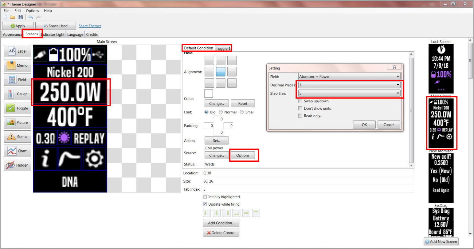

Hye sir, can you revise the watt increment adjustments in 0.5 increment? Or there is any way i can adjust it myself? Sorry very new to this theme & all that. Thanks btw.

Hi nashpantheron, watts are available in .5 increments from the REPLAY screen so you could work from there...or change the  increments displayed on MAIN screen by following these steps using Theme Designer in EScribe to edit the settings for both the Default Condition and Toggle 1 tabs shown below. Hope that helps?

Thanks so much for helping me out mate. It works now as I followed your guide above. God bless you mate.  🤗

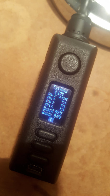

On 7/11/2018 at 6:28 AM, nashpantheron said:
Hye sir, can you add more details on the Battery Info menu? For example, can show stats of each Battery 1, Battery 2 Volt Info rtc. on tht Battery Menu Info. It will be much better. Kudos for your theme! 😃
Your request for battery stats have been included in V2.1. - see above screen shot
  • Thanks 1

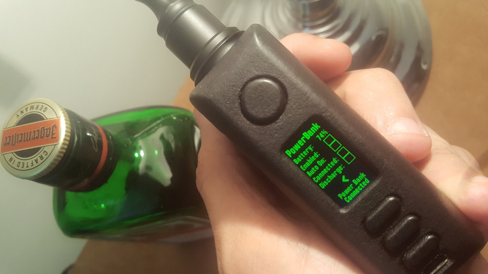

I have now included 'USB On-The-Go' for anyone wishing to use the 250c powerbank feature - included in V2.2.0
